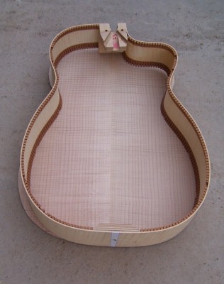

I saw this on ebay the other day and the going price was around $125
Can you tell why I wouldnt bid on it?
try to put a neck on that one
PostPosted: Tue Jun 19, 2007 3:02 pm

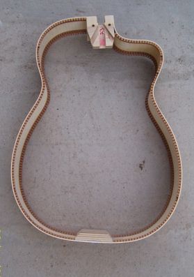

just a tiny bit of springback because it's out of the mold. when the plates are on it would be just great.... i mean really... wouldn't it... you mean....
PostPosted: Wed Jun 20, 2007 1:46 am
As long as they didn't use epoxy, the neck block should come off without too much of a problem. Better now than when the top and/or back is on it.
PostPosted: Wed Jun 20, 2007 3:30 am
not being facetious this time, the apparent misalignment of the neck block really is probably do to the obvious excessive springback in the sides. for example, look at the misalignment at the waist.
and i do seriously think that it could all straighten out if returned to and clamped in the correct mold. but you would have to have a mold in the correct shape to do it, and particularly so because of the cutaway.
however, the mold would not correct the obvious flaws in the kerfed lining for the top.
as to why i wouldn't buy it, what would i do with it. could i fix its flaws. sure, but it would take more time than building a rimset from scratch. it isn't my work so i wouldn't sell it. i don't brace my tops the way the neck block is designed to accommodate. just be useless clutter in an already too cluttered shop.
